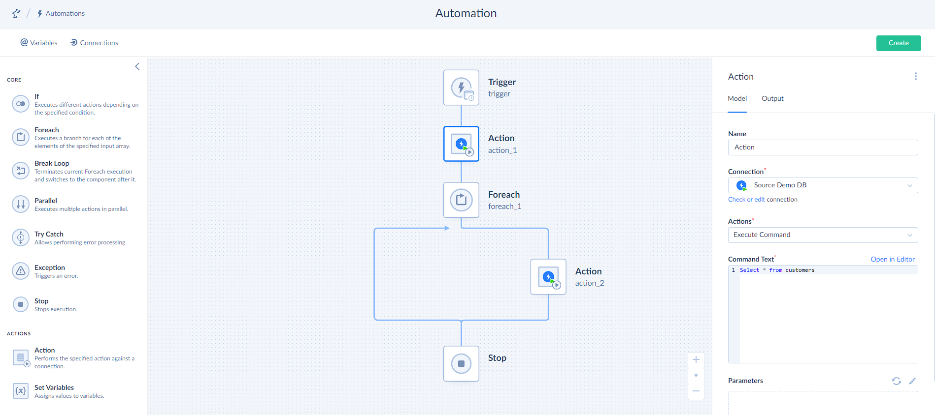

Foreach
The Foreach component is used to iterate over a list of items. It allows you to apply same actions to each item in the list. To choose a list of items to work with, select it from the List dropdown in the Foreach settings. Use the As box to set an alias name for the item.
Use Case Scenario
| Task | Solution |
| You have a list of customers and a mailing list. You need to add customers to the mailing list only if today is their birthday. | Add a Foreach component that accepts the list of customers. Add an If component inside the Foreach loop that checks if today is the customer's birthday. Assign an action that adds a customer to the mailing list to the True branch of the If component. |

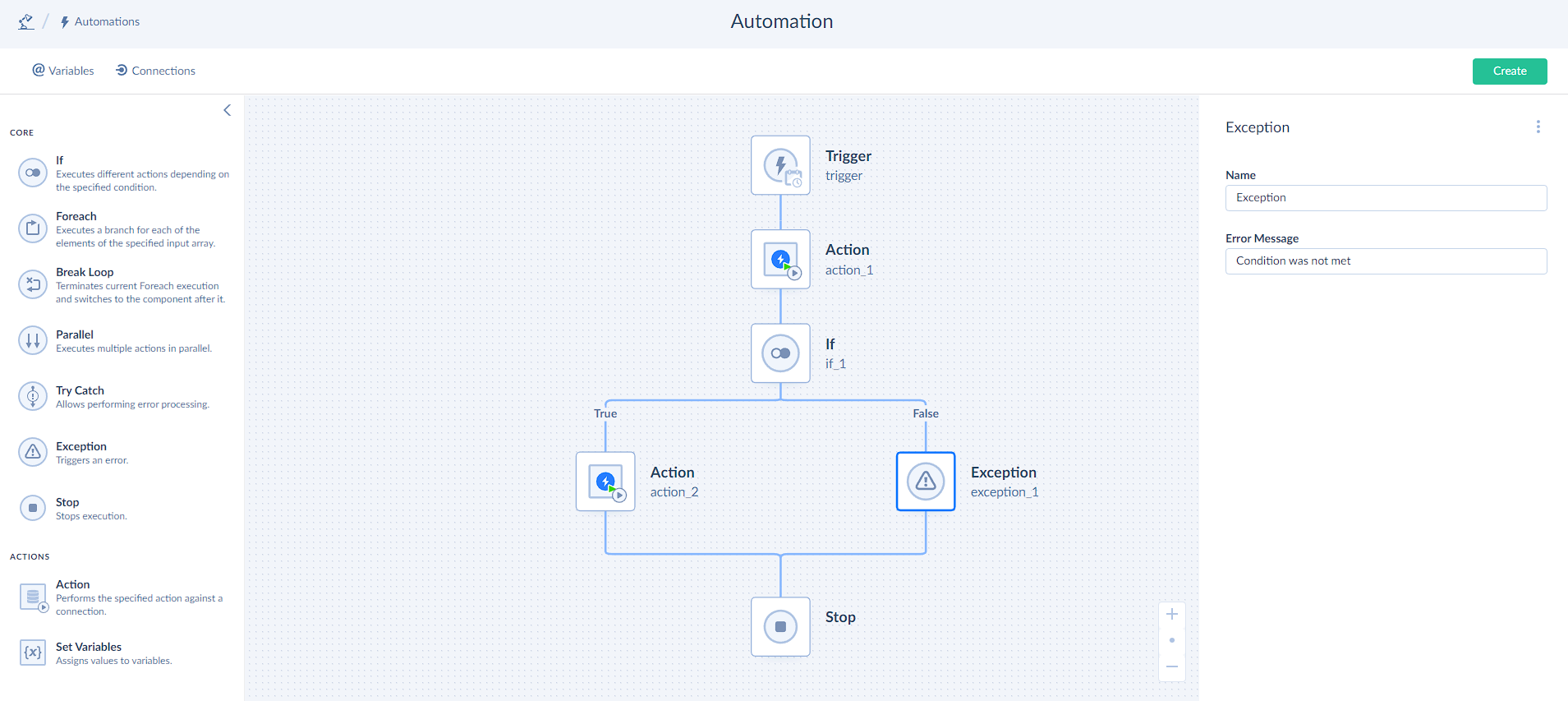

Exception
The Exception component can be used inside and outside the Try Catch component. When used outside Try Catch, Exception triggers an error, and the automation flow stops. When used inside the Try Catch component, it switches the execution to the Catch branch. You can set an error message in the Exception settings. It will be displayed in the Execution Details in case of automation failure.
Use Case Scenario
| Task | Solution |
| You have a customer. You need to create an account for him only if his age is 18 or higher and send him an email only if the account was created. Otherwise, the automation should be treated as failed. | Add an If component that checks if the customer's age is > 18. Assign the create account action to the True branch and Exception to the False branch. Optionally, set an error message in the Exception settings. Add the send email action after the If component. In this case, an account will only be created if the customer's age is > 18, and an email will be sent only if the account is created. If the age is < 18, the automation will fail, and you will receive an error message in the Execution Details. |
