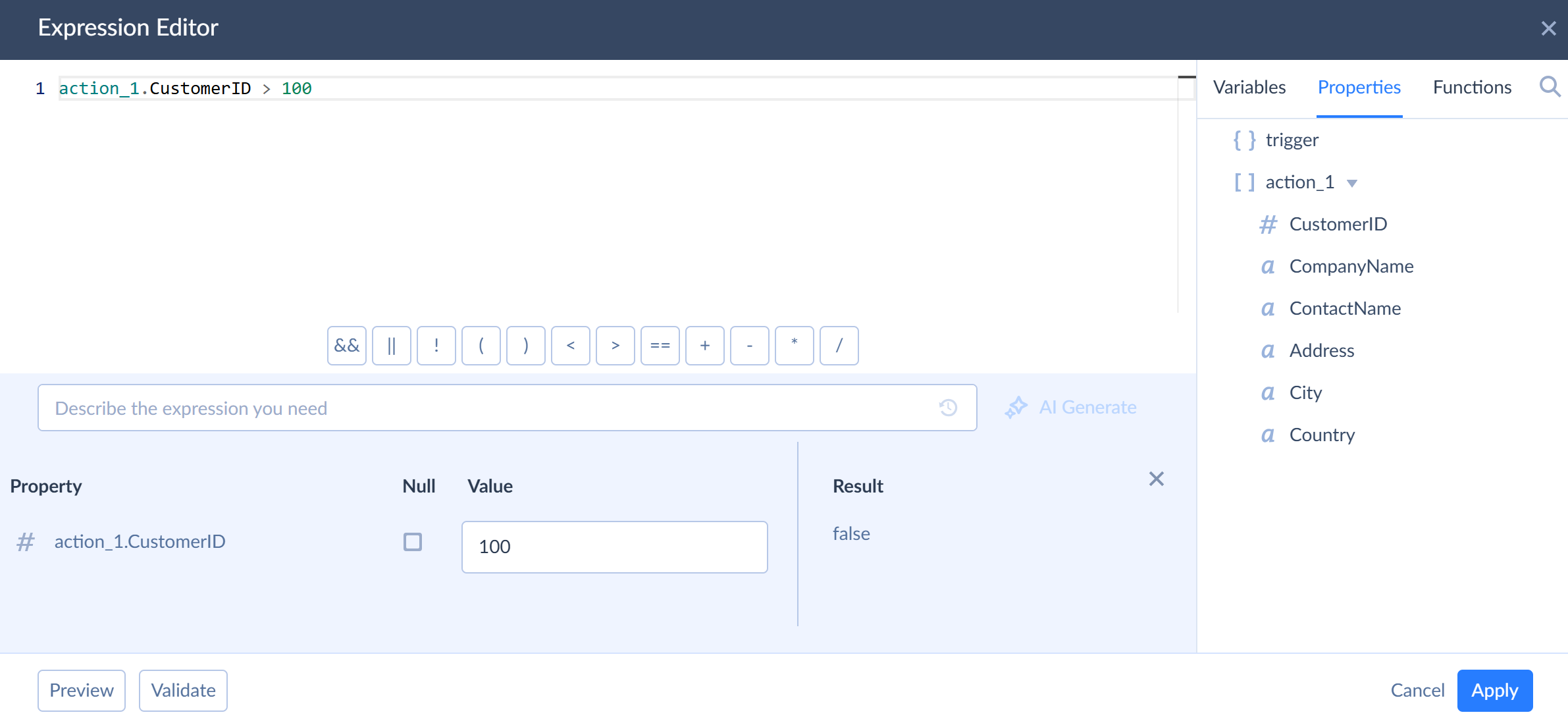

Preview
Preview
Preview pane allows you to check the expression results by manually setting values to properties and variables.
Validation
Validation
Use Validate button to check if your expression is valid. If it is not, you can check the reason by clicking Details. Moreover, Expression Editor automatically underlines the invalid elements of the expression in the Expression Area.
Expression Editor provides code completion. To use code completion, start typing your expression and Skyvia will offer you the autocomplete options.

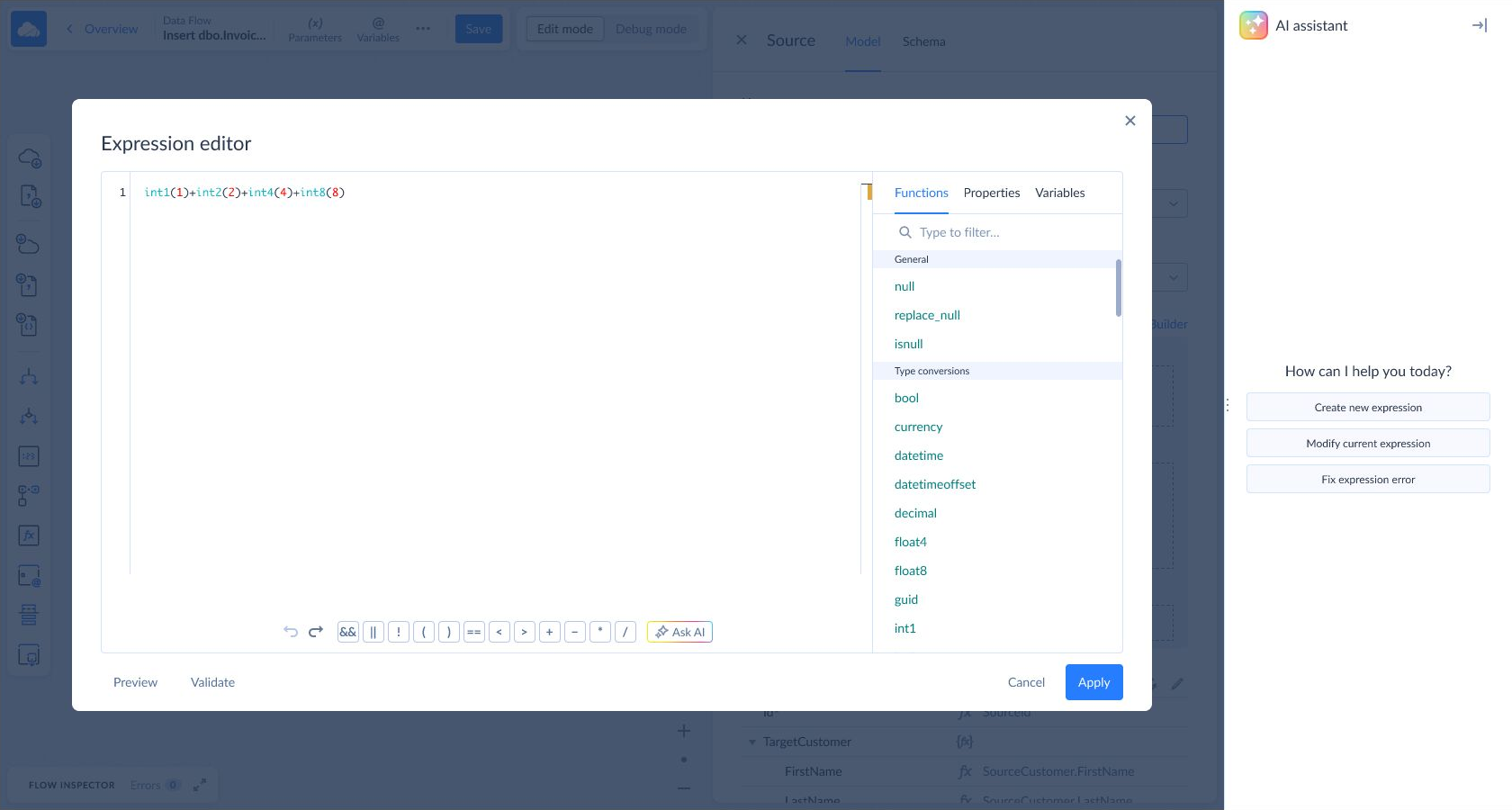

AI Assistant
AI Assistant can help you create a new expression, modify the expression currently displayed in the Expression Editor, or fix an expression that contains an error.
To open AI Assistant, click Ask AI below the Expression Area.
AI-generated expressions may contain errors. Review the result before using it in an integration.
AI Assistant Modes
When the Expression Editor contains an expression, AI Assistant provides the following modes:
AI Assistant mode selection
  • Create new expression — Opens an empty chat where you can describe the expression you want to create.
  • Modify current expression — Sends the current expression to AI Assistant. Describe how you want to change it when prompted.

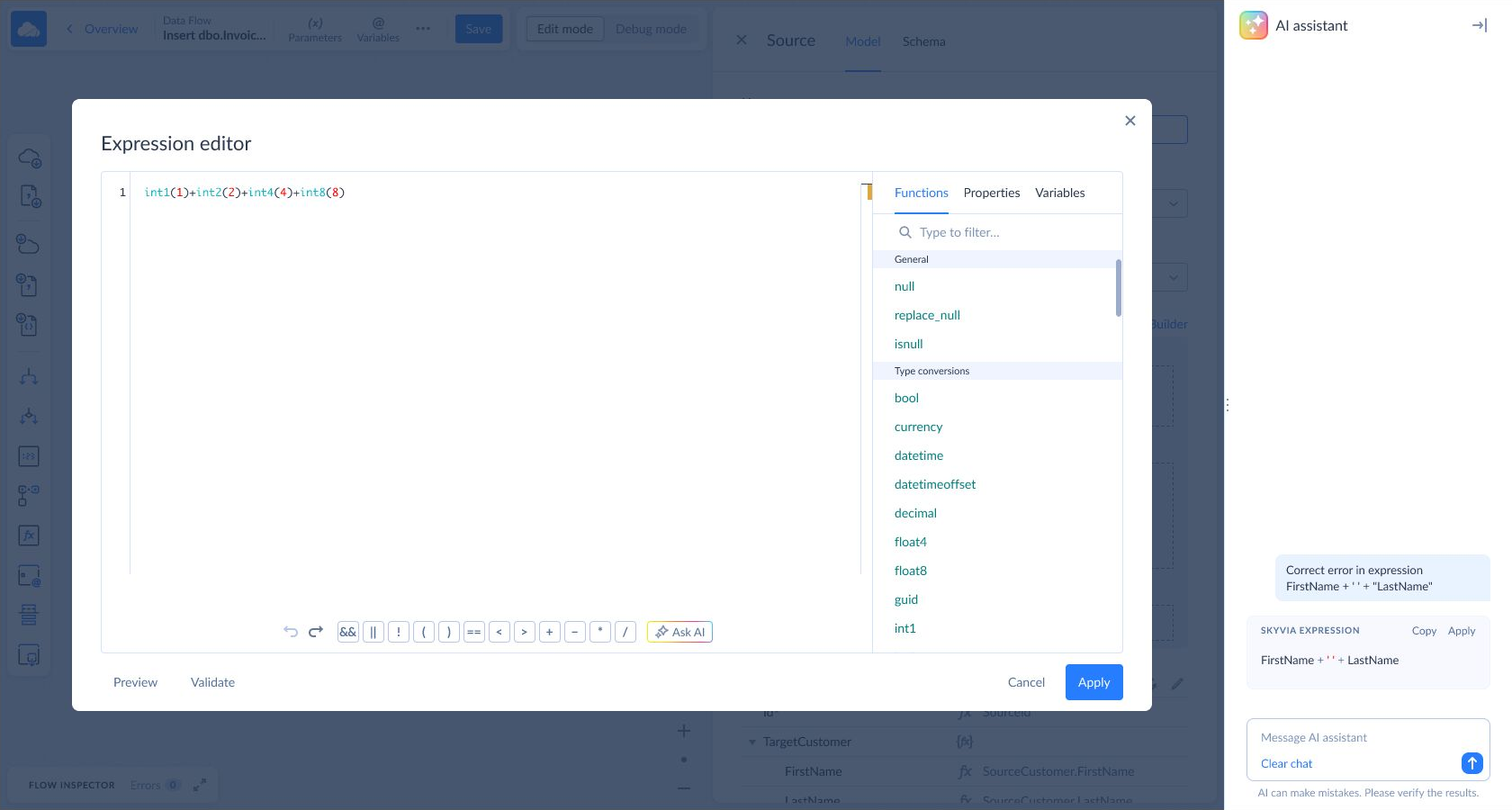

  • Fix expression error — Sends the current expression and, when available, information about the detected error. AI Assistant either suggests a corrected expression or asks for additional details.
The Fix expression error mode is available only when the Expression Editor has detected an error.
AI Assistant fix expression error flow
When the Expression Editor is empty, AI Assistant opens directly in the Create new expression mode without displaying the mode selection screen.
Working with AI Assistant
Enter your request in the chat and provide any relevant details, such as:
  • The expected result
  • The columns or values the expression should use
  • Conditions that the expression should handle
  • Examples of input and expected output
  • Changes you want to make to the current expression
You can continue the conversation to clarify your request or refine the generated expression.
AI Assistant working chat

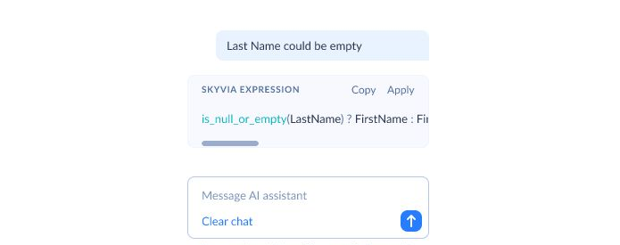

Using Generated Expressions
Expressions returned by AI Assistant appear in syntax-highlighted code blocks.
Each code block provides the following actions:
  • Copy — Copies the expression to the clipboard.
  • Apply — Replaces the expression currently displayed in the Expression Editor with the generated expression.
