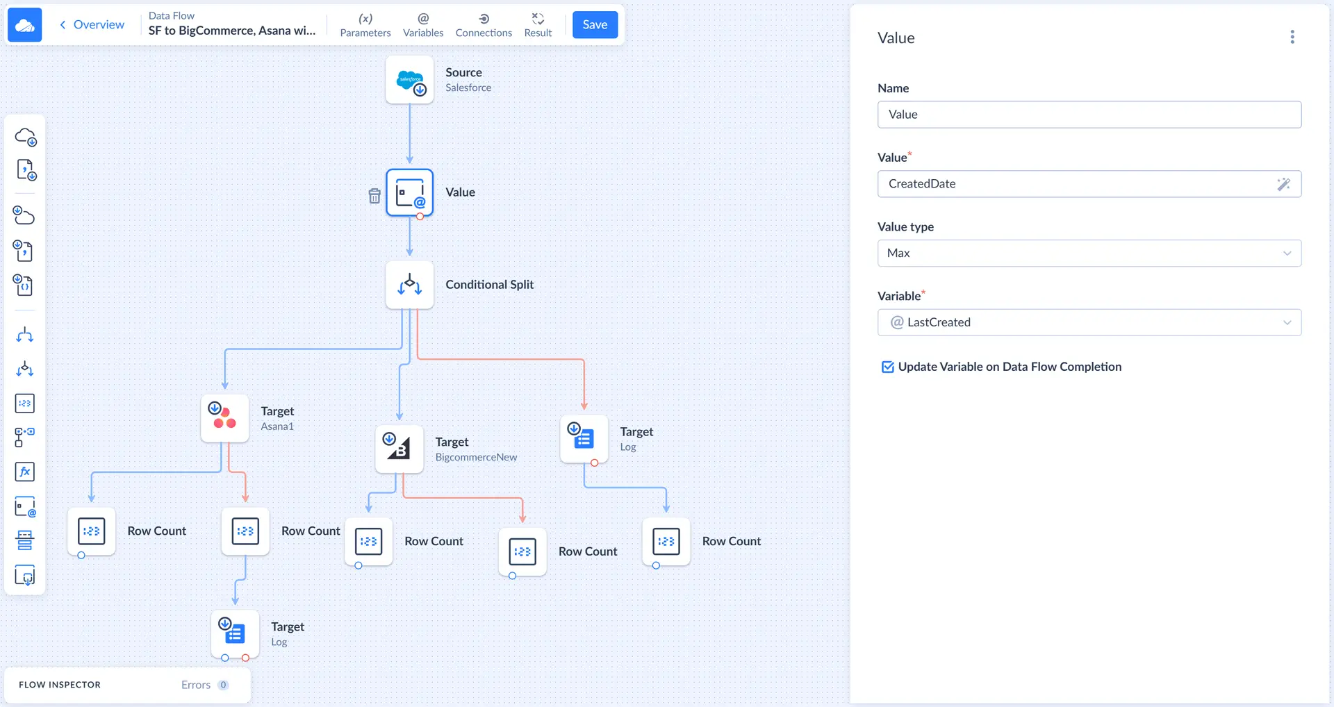

To configure the Value component, enter an expression by using our expression syntax into the Value box. In a simple case the expression is just the name of an input column. To create complex expressions use Expression Editor.
Then select the Value type — min, max, first, or last. Finally, specify a Variable to store the value in. You can also provide a Name for the component, which is displayed on the diagram.
The Value component can update the variable either after processing each batch or when data flow completes. The latter is useful if you want to use the variable in other places of the data flow before changing its value. If you want to change the variable value only when data flow completes, select the Value Update On Data Flow Completion checkbox.
