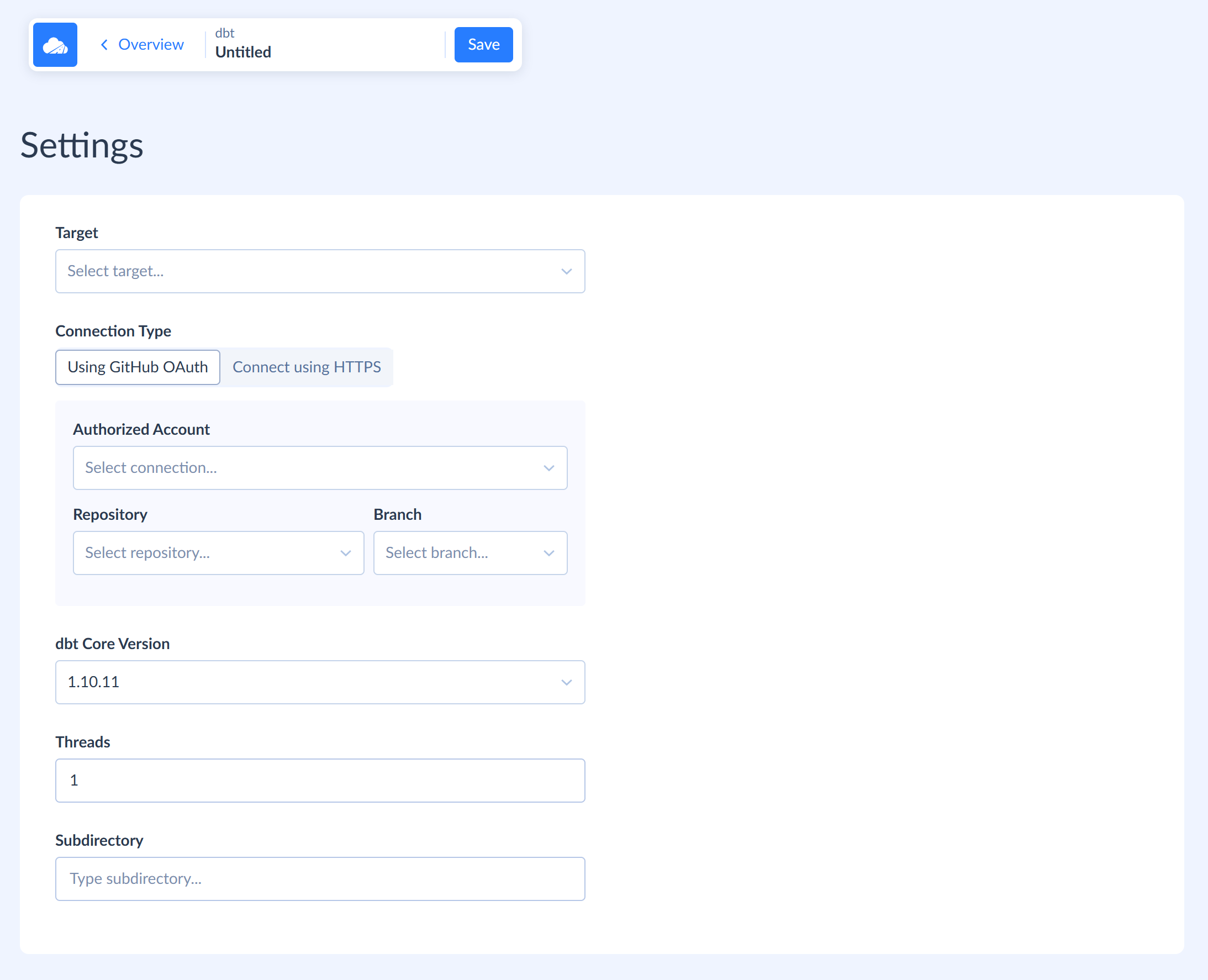

GitHub Connection
To use a GitHub connection, perform the following steps:
  1. In the Authorized Account list, either select an existing connection to GitHub or click New Connection and create a new GitHub connection.
    New dbt transformation - GitHub OAuth
  2. Select the Repository and Branch to build and run.

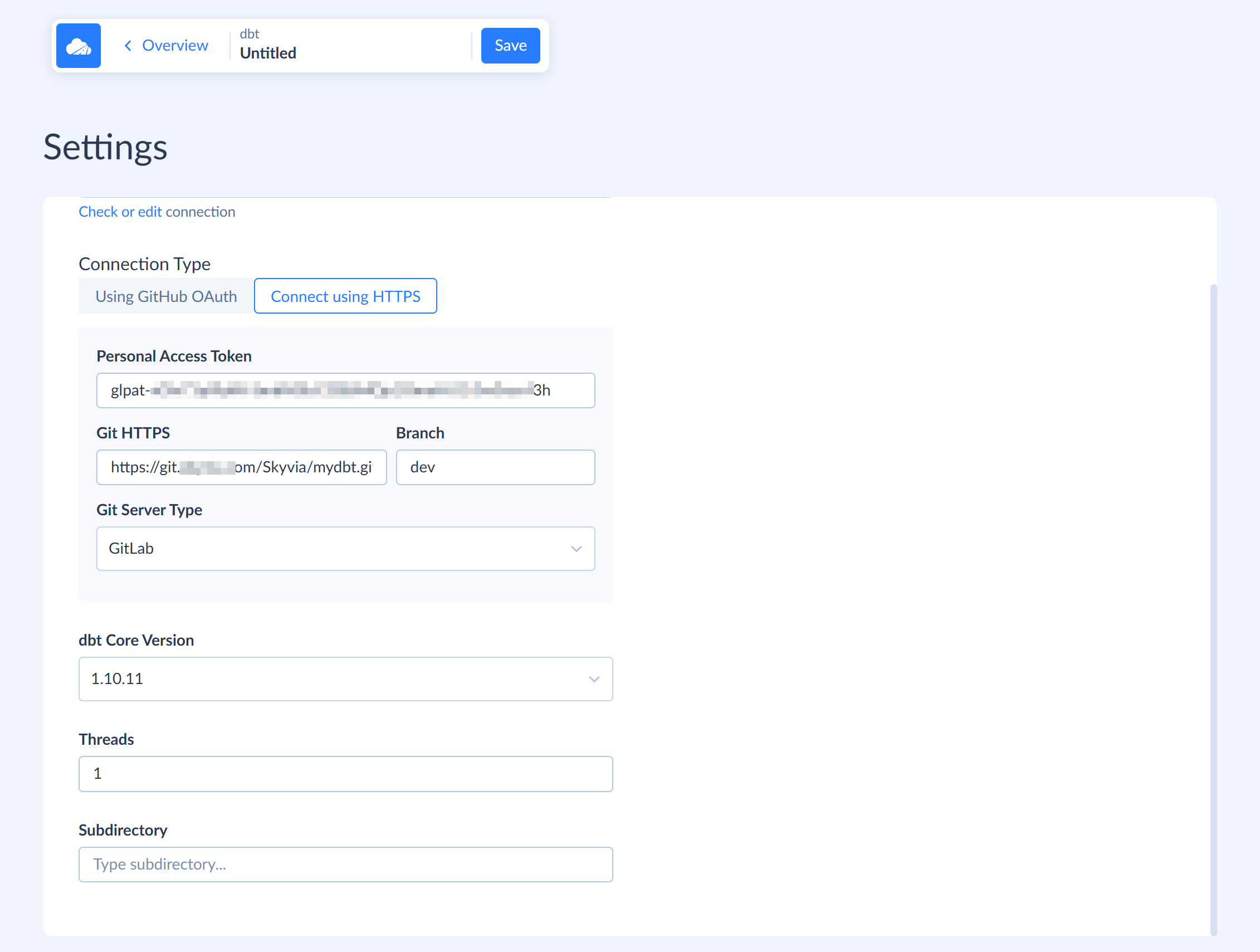

HTTPS Connection
To connect using HTTPS, perform the following actions:
  1. Click Connect using HTTPS.
  2. Specify your Personal Access Token, for example, glpat-xGlv71qf9pW-SmbNGlcCl286MQp1OmoH.01.0w3ryc43h. We recommend using a token with at least read-api scope.
  3. Specify the Git HTTPS URL of the repository and Branch to build and run. Note that the specified URL should be the repository clone URL that ends with .git.
  4. Select the Git Server Type: GitHub, GitLab, BitBucket, or Unknown.
New dbt transformation - HTTPS connection
See how to obtain Personal Access Token for:
  • GitHub
  • GitLab
  • BitBucket. BitBucket calls it App password, but Skyvia uses it in the same way as access tokens for other servers.
