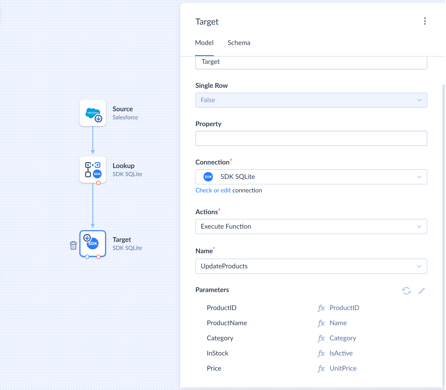

Target Methods
Target methods are used in the Target component in Data Flow. Usually, such methods perform operations like insert, update, upsert, delete, write, send, etc.
Target component
Requirements
The method must:
  • be a public method of the provider class
  • be marked with the ProviderActionType attribute with ActionType value including ProviderActionType.Target
  • work in batch mode, which means that:
    • method must have a special parameter parameters which is a collection of objects
    • method returns a collection of objects
    • the size of the output collection must be exactly the same as the size of the input one in order for Skyvia to match each record processing result record with each input record.
Method Signature
The method signature looks like the following:
1
Task<IEnumerable<TResult>> MethodName(IEnumerable<TParameter> parameters, CancellationToken cancellationToken)
Where:
  • TParameter is a class that represents input parameters
  • TResult is a class that represents the result of input record processing
Parameters
The method must have a special parameter parameters representing a collection of objects. Fields of the class represent the action parameters. You can use the Required attribute to mark the required parameters. For example:
1
2
3
4
5
6
7
8
9
10
11
12
public class InsertProductParameter {
[Required]
public string ProductName { get; set; }
[Required]
public string Category { get; set; }
[Required]
public bool InStock { get; set; }
[Required]
public double Price { get; set; }
Result
There must be a separate class for the method result, for example:
1
2
3
4
5
6
7
public class TargetResult
public long? Id { get; set; }
[Display("$$error$$")]
public string ErrorMessage { get; set; }
If the result has a string field, marked with the [Display("$$error$$")] attribute, this field has a special meaning for Skyvia. It is used to separate the failed and succeeded records. If this field has a value in the method result, the corresponding record is redirected to the Error Output of the Target component. Otherwise, the record goes to the Success Output. This allows processing the entire buffer of records and distributing them into correct outputs even when there are errors in some of the records.

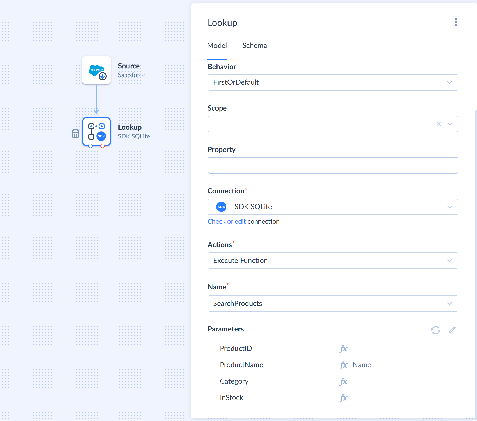

Lookup Methods
Lookup methods are used in the Lookup component in Data Flow for looking for the data and enriching the input stream.
Lookup component
Requirements
The method must:
  • be marked with the ProviderActionType attribute with ActionType value including ProviderActionType.Lookup
  • have the special parameters parameter that is a single object instance, not a collection
  • return either a sinle instance of an object or a collection of objects
Method Signature
Here are examples of a typical method signature:
1
2
3
Task<IEnumerable<TResult>> MethodName(TParameter parameters, CancellationToken cancellationToken)
Task<TResult> MethodName(TParameter parameters, CancellationToken cancellationToken)
Where:
  • TResult is a class that represents a record from the data source
Parameters
The method must have the special parameters parameter that is a single object instance, not a collection, or an instance of a simple type. Fields of the class represent the action parameters. You can use the Required attribute to mark the required parameters. For example:
1
2
3
4
5
6
7
8
public class SearchProductsRequest {
public long? ProductID { get; set; }
[Required]
public bool? InStock { get; set; }
Lookup method can have the parameter parameters of a simple type, for example:
1
Task<Product> GetProduct(long parameters, CancellationToken cancellationToken)
However, this is not recommended. Having a separate class for input parameters is better as it provides more flexibility for an SDK provider, allows working with parameters metadata, and makes the future method extending easier.
Result
1
2
3
4
5
6
7
8
public class Product {
public long ProductID { get; set; }
